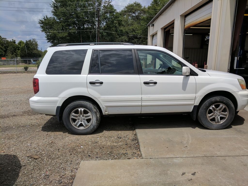

    So I originally planned on walling my Civic after this season of competing in the trunk class. Was going to do 4 12's on 12k watts, but doing to math on all the weight added to the car, it just wasn't going to work out like I wanted it.
    So I bought this today...
    Have to replace the transmission in it first, then get to work on everything else.
    Going to do it no wall to begin with.
    Will be slow going on this build initially. Gotta get through finals in early September, then sell the Civic and my old amps to fund a lot of this build.

    So this happened today. Got the new transmission in. Have to do 20 min worth of work to it tomorrow and test drive it, but it should be done.
    After working in it, it's obvious this thing has been neglected. Will be replacing timing belt before I start driving this thing. Paint is pretty dead as well, so it'll get a good polish soon.
    My Civic is as good as sold, and the guy is willing to wait till after finals to get it. So September 11th it'll get taken apart, sold, and the real part of this build will begin.
