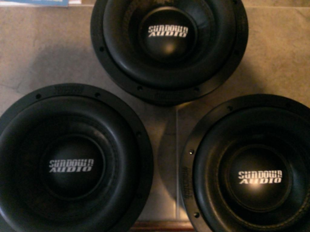

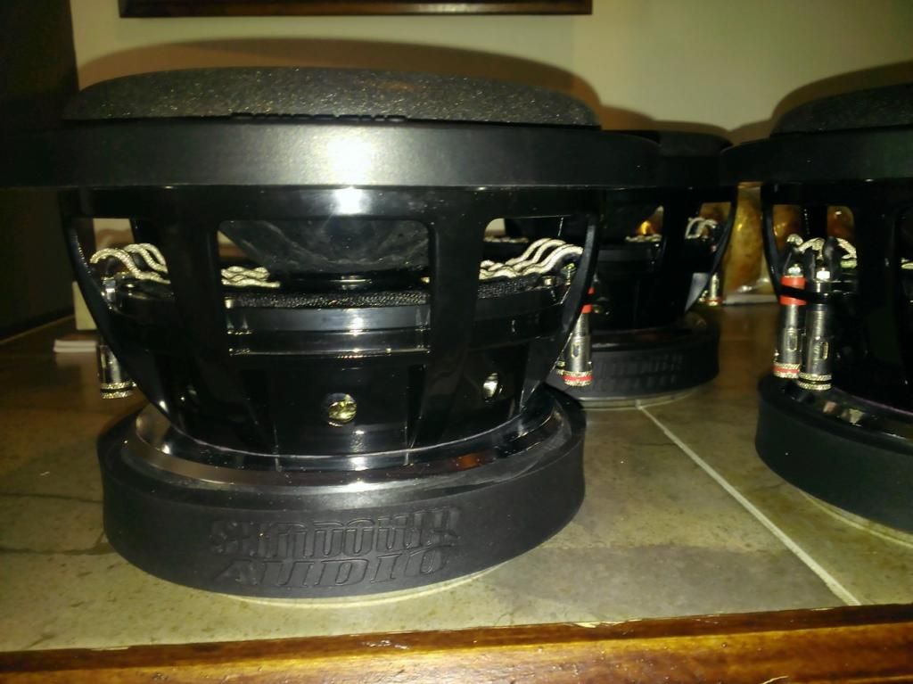

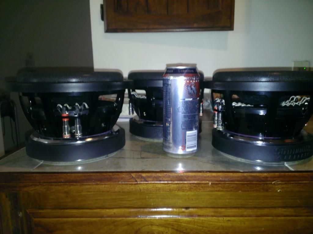

    So I picked up my new ride in October and it came with the sony premium audio which was weak as hell so I decided to upgrade. I figured I'd start with the substage as the factory speakers aren't that awful.
    I want to do this as more of an SQ build than anything. I have been intrigued by the Sundown SD8s for awhile and saw an opportunity to use them.

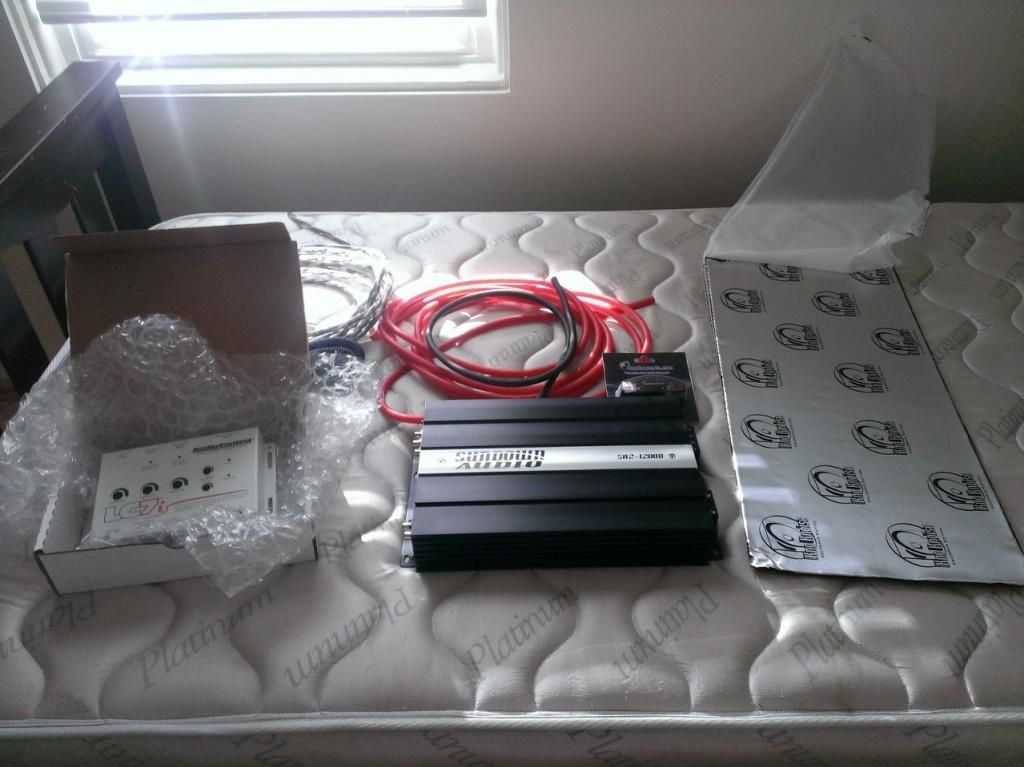

    Equipment list:
    Sundown SD8 d4s x3
    Sundown [email protected]
    All wiring is Knukonceptz
    Knukonceptz kolussus 100mil sound deadener
    Old school rockford Fosgate punch 250a2 and some PHD passive crossovers
    Audiocontrol lc7i
