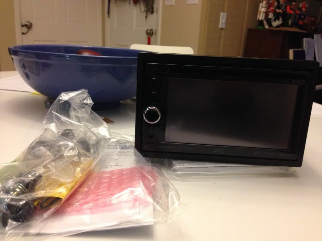

Since it was Xmas, I decided my present was going to be an audfio overhaul. I found a JVC AV61BT on sale at Best Buy for $229 (down from $349) and I picked up a set of Infinity Primus PR 6500cs components for the front doors (I'l do the back seat soon).

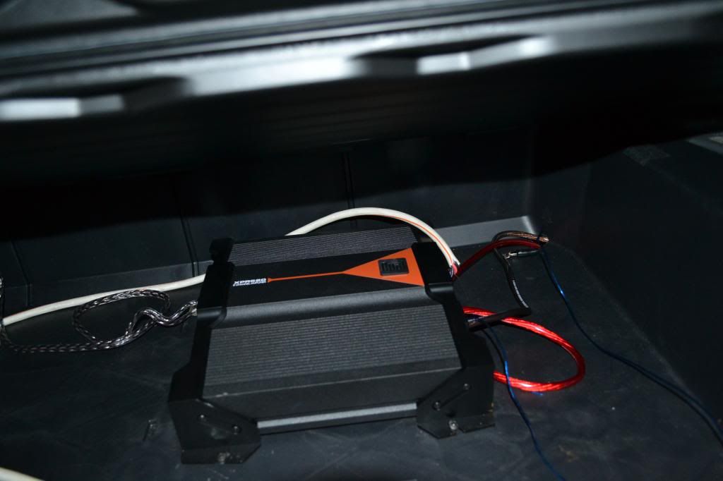

I looked around quite a bit over the last week or so. I didn't want to spend a ton on a sub. I didn't want a huge box. Finally I found that Best Buy was clearing out the Polk Dxi108 and selling them for $75. That's $75 for the speaker and the enclosure. So I drove to Cedar Rapids (the local best Buy didn't have any in stock) and then went to Wal-Mart and got a $59 Dual XPR520 amp and a $25 Schoche install kit. In and out for just a little over $150.

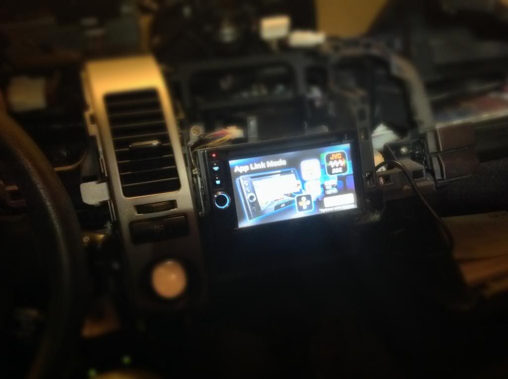

The install was pretty easy. I continue to be amazed at how easy it is to get the Prius apart. I've had the dash apart 3 or 4 times now and it's just as easy as anything. I ran the remote power cable for the amp down the passenger side and the RCA cable down the driver's side The panels along the doors came off so easy as well. I tucked the cables up around the back seats and into the cargo tray. Then I Attached the power cables and the ground. Fired the thing up and was golden.
