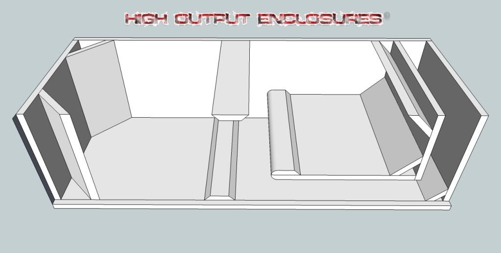

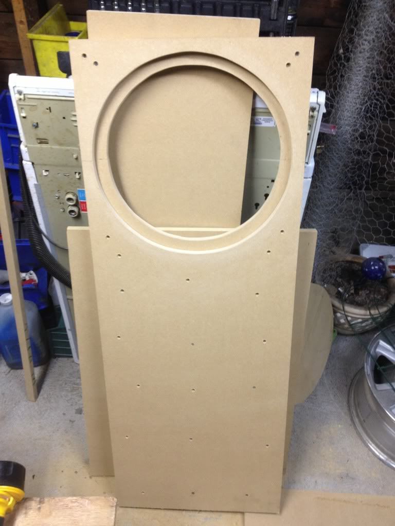

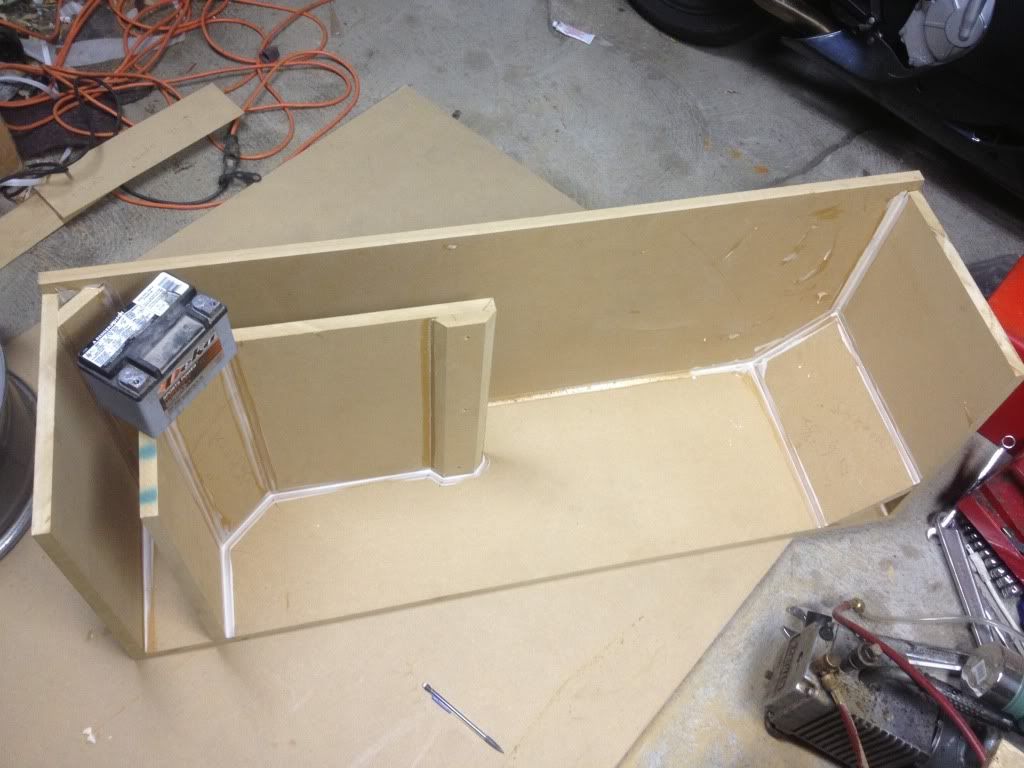

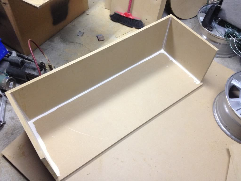

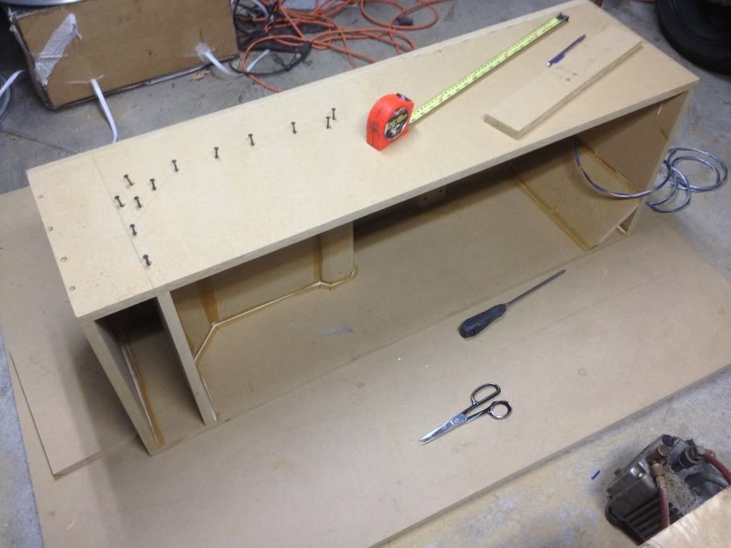

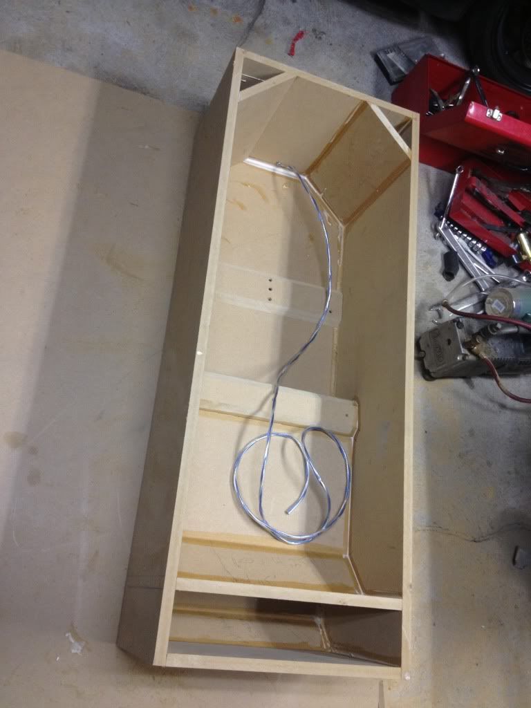

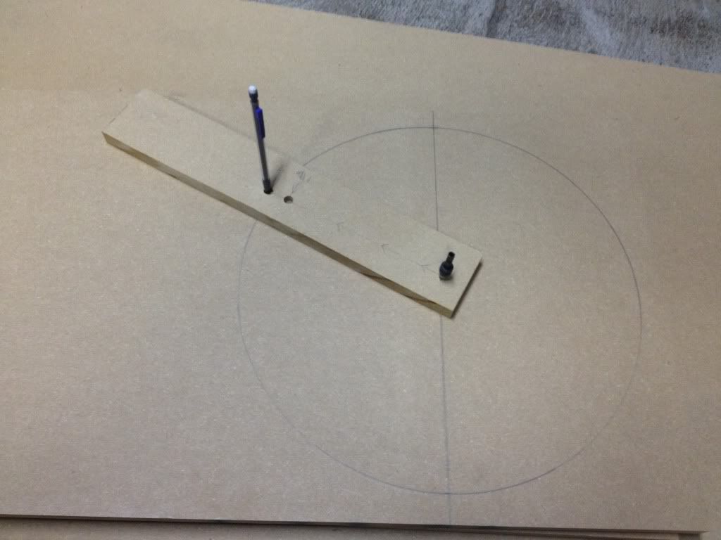

    Hey guys. Just finished building my enclosure for the C2 Threatcon 2 15".
    The box was designed by Buck from High Output Enclosures.
    It's just under 4ft^3, and tuned at 32Hz.
    F3's of about 28 and 60.
    3/4" MDF. Glued, screwed, braced and double baffled.
    I'm going to put it in my truck as soon as it stops raining. It's being powered by a VFL 4480.
    Thanks Chris and Buck.

    I think it's 4 cubes, not 2.
    You don't know what you're talking about.
    That's a typo. Editing now..... Thanks

    Np, looks solid!
