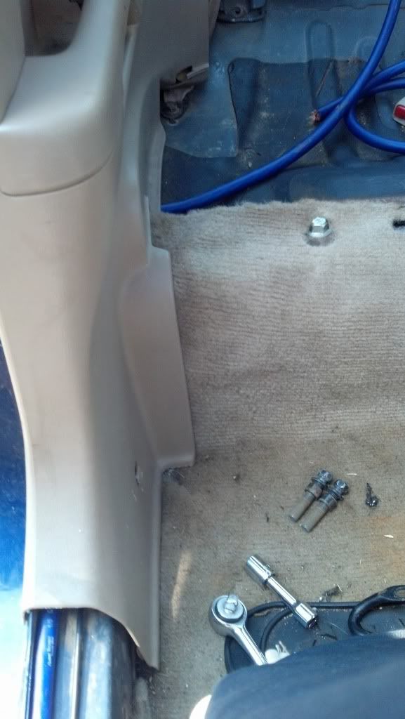

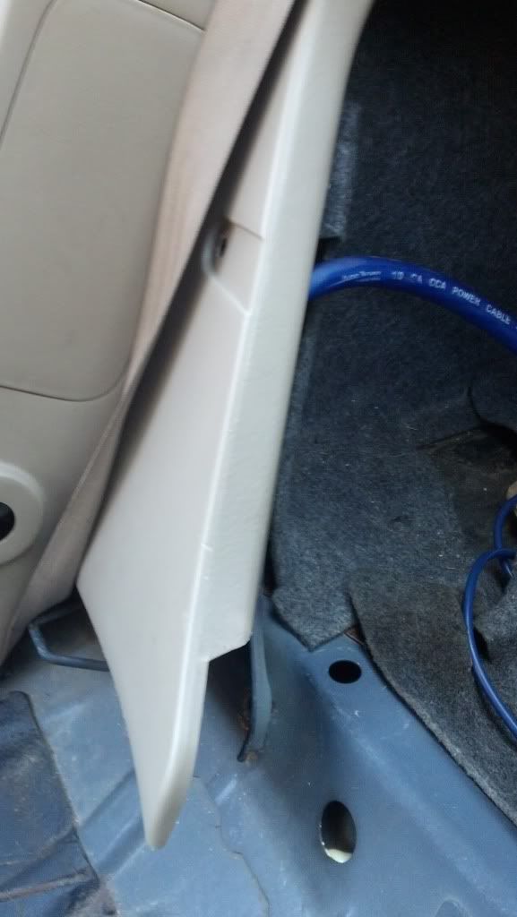

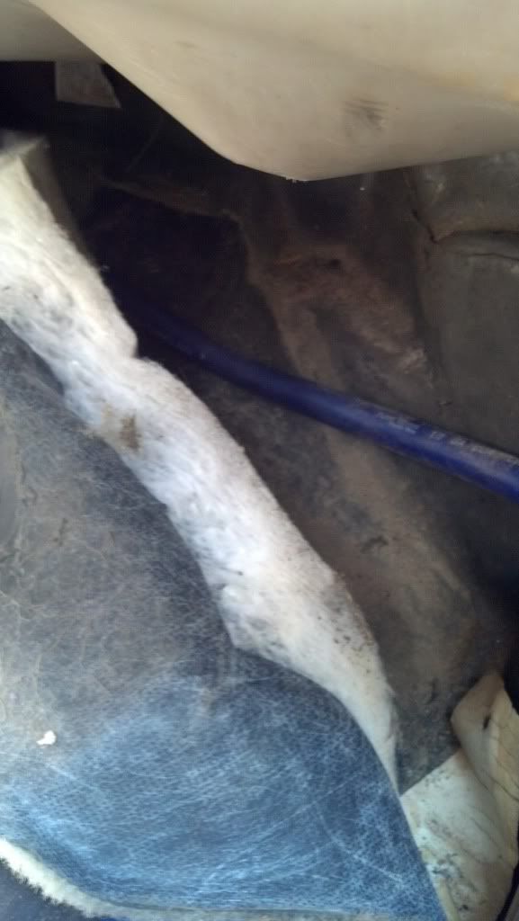

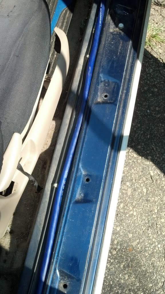

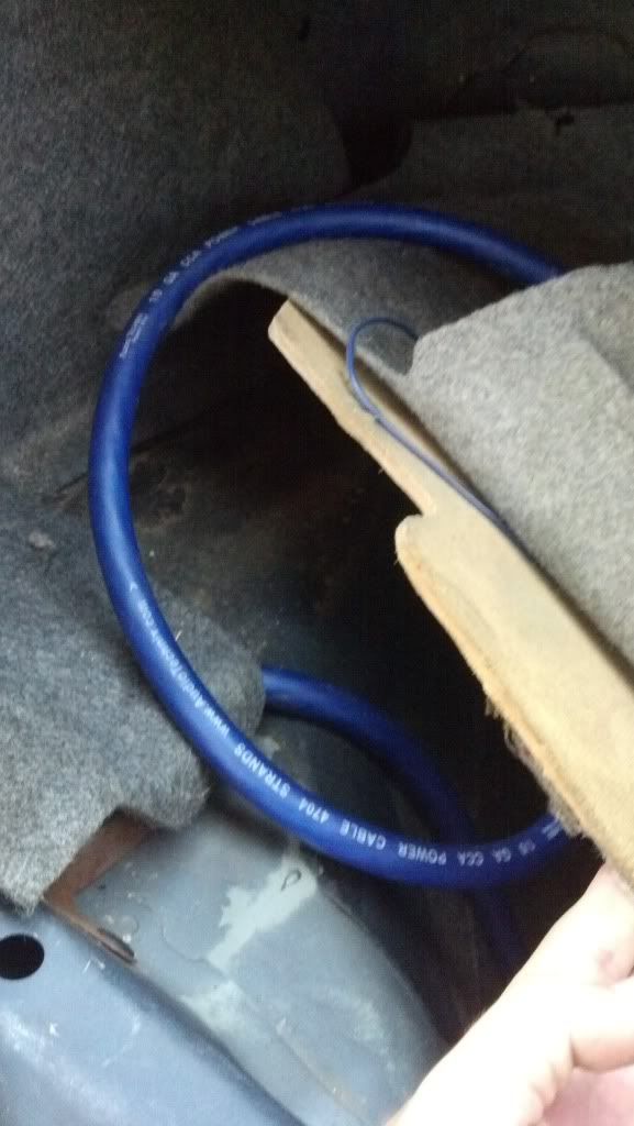

    Ran the power wire to the back tucking it in between, behind, and under trim pieces to keep it nice and hidden. Tucked it under the carpet in the back, when i get the sub amp the carpet will be cut and the wire will run under the carpet to the hole then into the amp.
    Ground was done the same as the power wire, and will be ran the same way.

    All wires ran, i forgot to tuck the ground back under in this pic.
    Trim pieces back on. No traces of a big ass wire anywhere.
