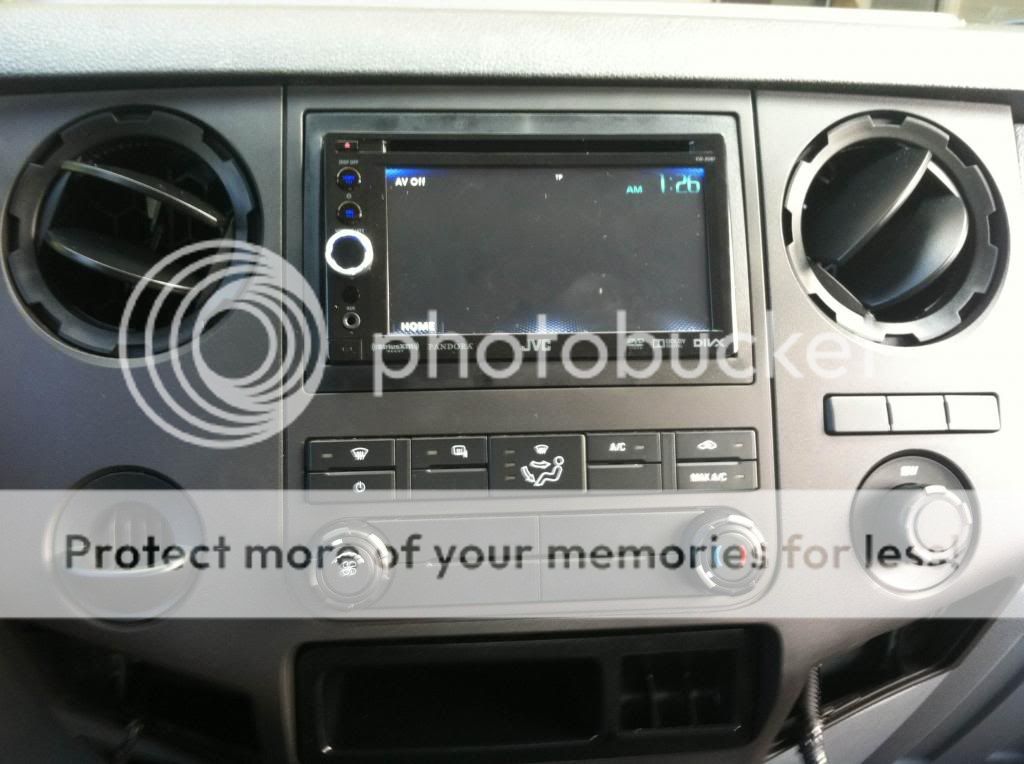

    Update for today: Installed the JVC head unit. What a pain in the @ss, the mounting kit did not match the required height of the head unit for the dashboard to fit on properly. I simply modified the holes in the plastic mounts by drilling new ones in the side. I also received my 'Knu' 1/0 awg wiring today, which I'll install tomorrow.

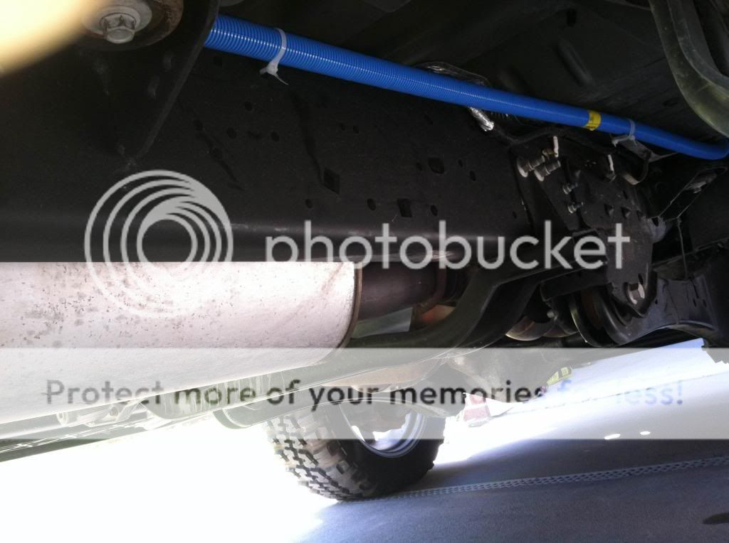

    Is there a particular reason you went under the truck instead of through it?

    Simply to avoid cutting a hole in my firewall. Also, there is a port in the rear of the supercab that made it convenient to put the huge 1/0 awg through - this will help facilitate mounting my amp directly behind the passenger side seat as the wire is already elevated. also, I was having serious problems getting the 1/0 to fit under the side panels without the rubber seal popping off!

    If you are gonna run the wire underneath like that, it would be highly advisable to invest in tech flex or something of the equivalent to protect the wire

    like the rest i would re run that power wire inside, you shouldn't have to drill a hole I did a f250 same year, and had no problem with 4 gauge through the factory grommet, at lest cover it in some loom or something, or mount it higher up.
    other than that looks like it should be a decent set up.

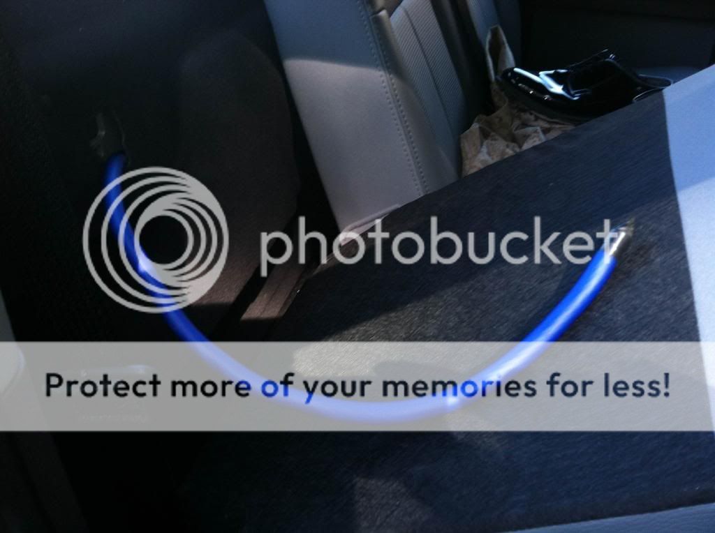

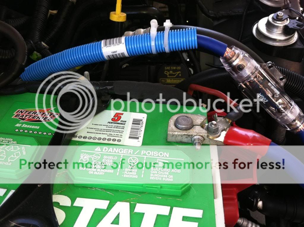

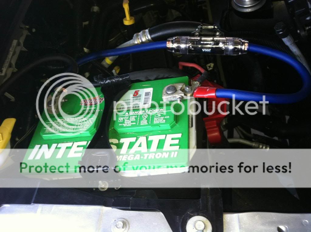

    Well, i took all of your advise and reinstalled the 1/0 awg wire. I went to Lowes and picked up a wire sheath for home electrical wiring, it isn't the prettiest but it should be functional and it was $3 for 10 ft! I added a bit of flexible sheathing to go around the cab where there is some significant chassis rubbing. Additionally, I wrapped the left side of the fuse holder/wire in electrical tape (not shown in pic) to increase the strength and prevent water from getting in the fuse holder/sheathing.
