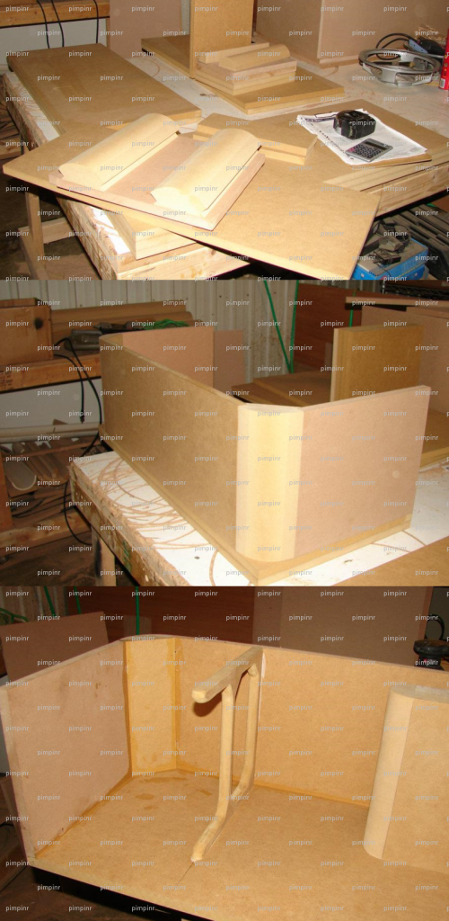

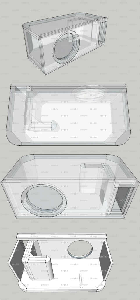

    Personally I would think about re-designing your port design... DD subs like a LOT of port length...

    Single 12" Ported Box
    3 cubes per side
    42 sq in of port per side 22" long

    then that pic is deceiving I guess lol... You should be fine then, as I believe the "DD Box" lands you around 39 sq. in. of port, I always just usually end up giving them more port & tuning lower than they recommend as it seems to sound better, but that's just imo, some ppl like them tuned higher...
