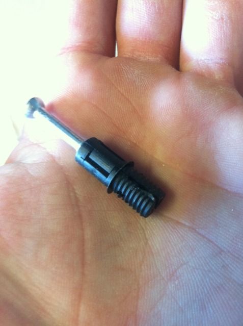

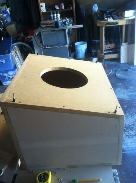

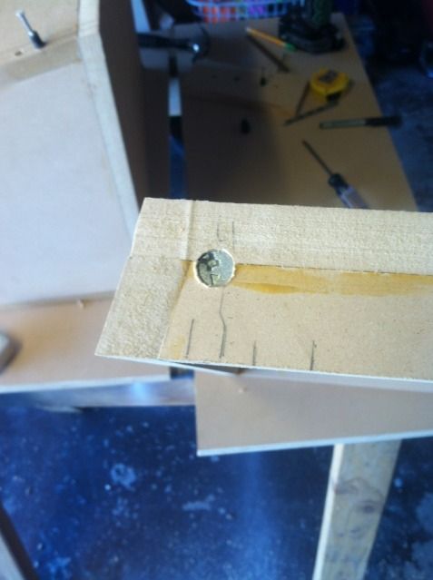

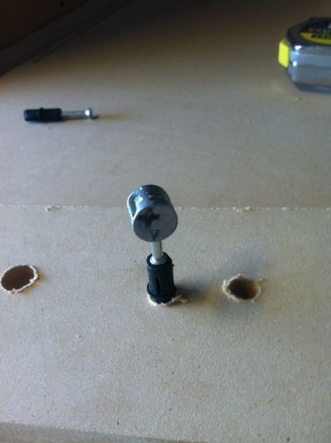

    Still have alot of sanding to do for this before i paint it!
    picture of the part. Make sure you account for the distance of the piece. im sure online they sell smaller length shafts.
    and just a visual without the wood as to how they work
    as you turn clockwise, your pulling the shaft up, in turn flaring the black plastic shroud with prongs thus tightening the two pieces together.
