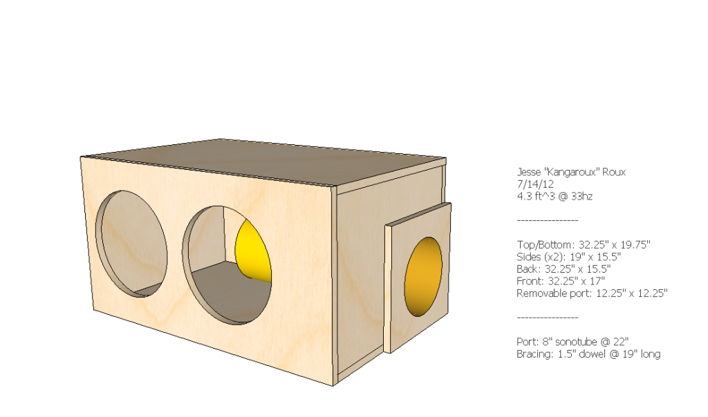

    Box:

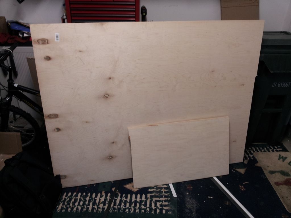

    Wood at the time, I cut some more and got the bottom, side and back glued:

    Re: 2 Obsidian Audio 12"s 4.3cft box~33hz
    4.3 seems a little large for the zv2... I would put it n about 3.2 cu ft with 18sq inches of port per cube, tuned to 34
    Quote Originally Posted by RangerDanger View Post
    I had already had it half made by the time it was said and done, obviously 1.3cft won't hurt the woofer since I had a VVX15 in 8.5cubes.
    Quote Originally Posted by VisceralSound View Post
    it could hurt it depending on the f3 and port area... iirc you vvx enclosure didnt have very much port per cube did it??
    2 8" sonotubes @25.25" long
