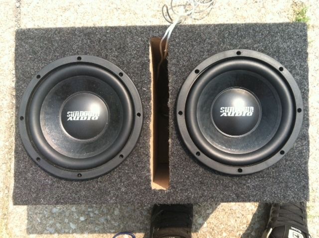

    Two sundown e8's ftw!:
    Front View of the box, right around 15 square inches of port, 1.1 cubic feet after displacements, tuned to 34 hertz:
    The side view of the box:
    Pic of the subs installed:
    The final install:
    My thoughts overall, the two e8's get way louder than the one we had in there obviously. They hit pretty hard. i have them on double the rms at 400 watts a piece and they are taking them like champs. i know its not the cleanest install ever, but he didnt want to cut up his carpet and having the wires running along the side was the best i could do.

    haha that was just for one. the reason the other was so big was because the cubic feet was so little the port had to be real long. so since this box was for two, i could make the port shorter while still getting the same desired tuning.
