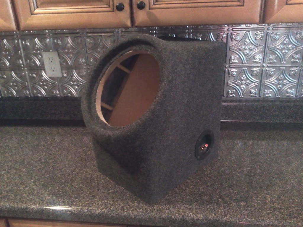

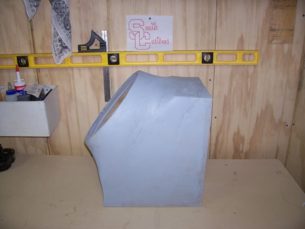

First one was for a 2009 Chevy Colorado Extended Cab. It will be holding a 10" Kicker CompVR between the two rear seats. Had to work with fiberglass to get the box to fit and still hold a 10" sub. Should provide nice output in a small space.

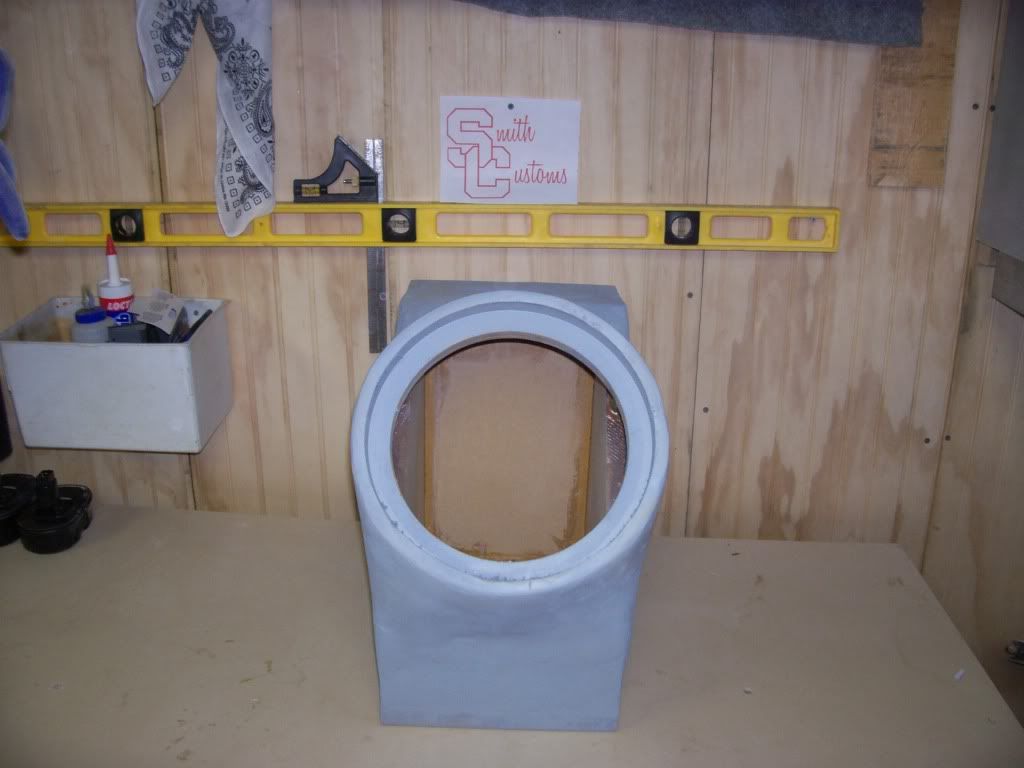

Second build was for a 2000 Buick Park Avenue. A bit more power in this vehicle than the last for a 12" Audioque HDC3. Box was 2.20cuft @ 38hz. All exterior edges were rounded over, but I didn't get a picture of that prior to carpet.
