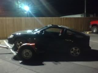

    Helped my friend get his truck home.:
    This bad boy set a world record for USACi stock 1801-3000 last year of 162.8. hopefully it does just as good this year in 601-1800... but does it laid out.
    I did manage to move my ports to the inside of the box and got another 10th...
    I'm hearing now that some loud people aren't going to be showing up at the show today. I was going to get all four 10L7s into my box and see if I could do better, but I'm just going to do SB1 this round.
