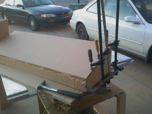

    Dual E8 S10 build
    Well doing a box for a guy at work. He has early 90's S-10. I'm putting 2 Sundown e8's in it. The box is 49" wide 16" 10" deep at bottom 5" deep at top. Doing the subs flushed in and port out the side. So far the sides,top and front are on. Using staples and clamps ftw. More pics to come.

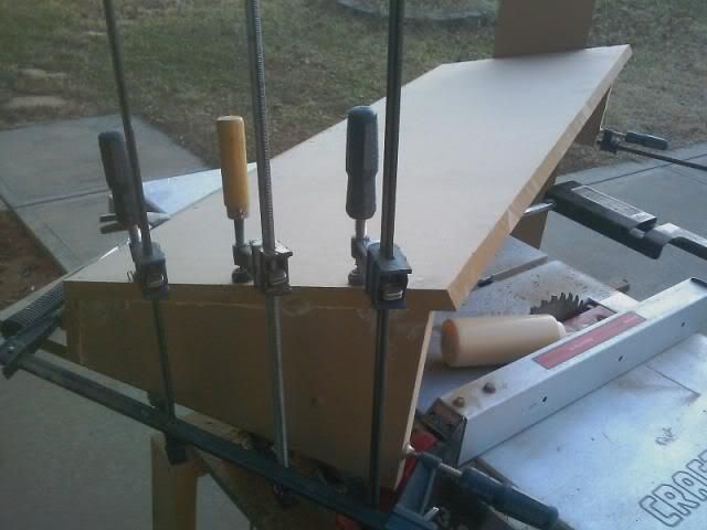

    more pics? how did you cut the slant for the box? I've always wondered how.

    Well i gotta give thanx to my buddy Justin for helping me do that as it's my first wedge box also. But I also bought a taper jig from sears that can help do it all. Box is 1.7 cubes tuned to 32. We are designing the port up now. But did a mock up port and it's 1.7 after port.
