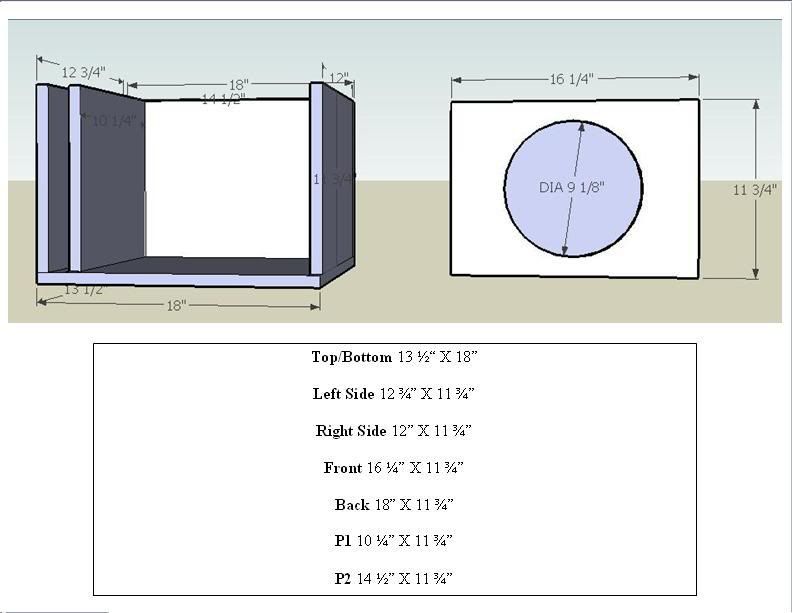

    Rockford Fosgate P325.2 and JL 10w1v2.4. Got these for Christmas hopefully i will get them installed by the end of the week.
    Box design using the JL specs that came with the sub 1 cubic feet tuned to 31.0 Hz
    Comments suggestions?

    I find that JLs recommendations are a little small for my likings.

    Does the Port seem narrow? Im sure its like 1" but just curious

    Yea its a 1" port it is kinda narrow but that's what the JL specs called for.
