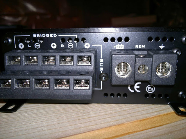

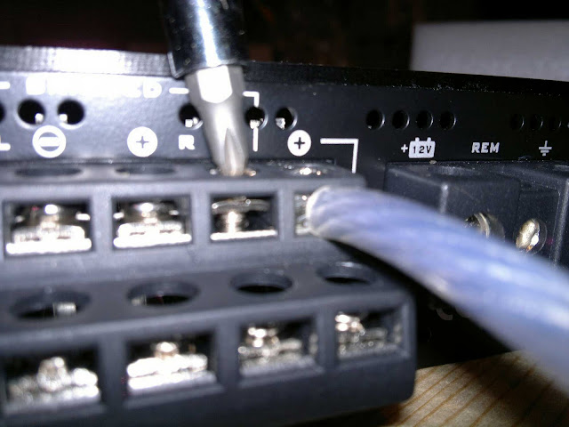

    HEre are some more pics.
    All aesthetic aspects of the amp are nice.
    HEre you can see the terminals where it is particularity easy to use , you can't unscrew the screw and square metal plate completely since there is a plastic part keeping it from popping out completely, so feel free to unscrew it completely and jam in huge wire. Not using disconnects has never been so easy hehe.
    8awg wire
    Below you can see ALL terminals use the same philips screw... I am in love.
    Of course one never wants to over tight since the it seems like it would be challenging to swap out new screws.
