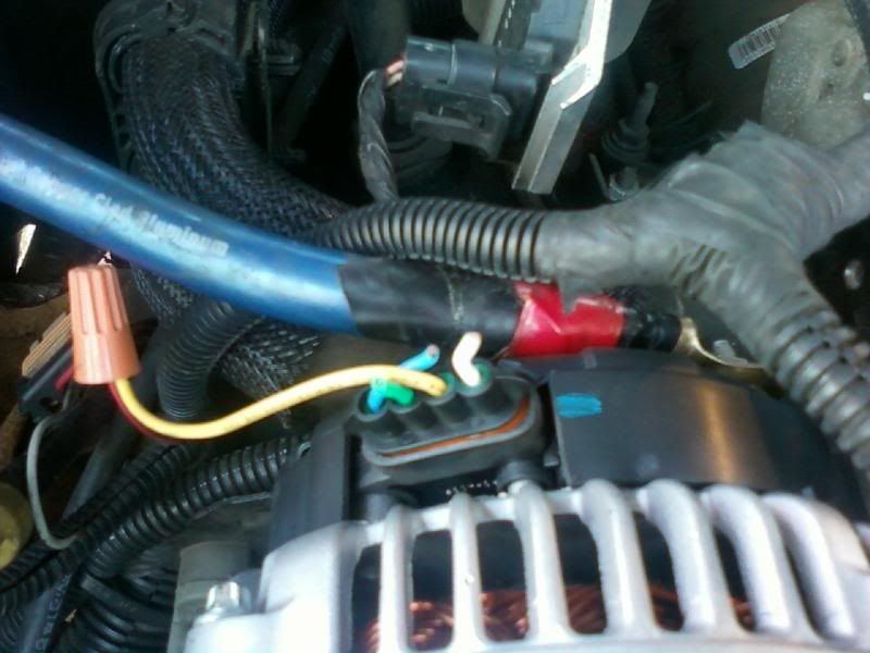

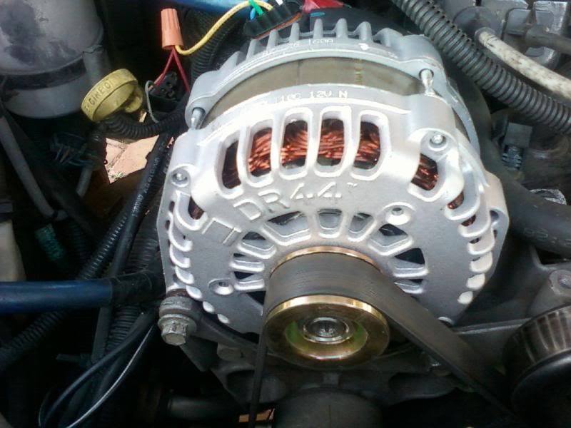

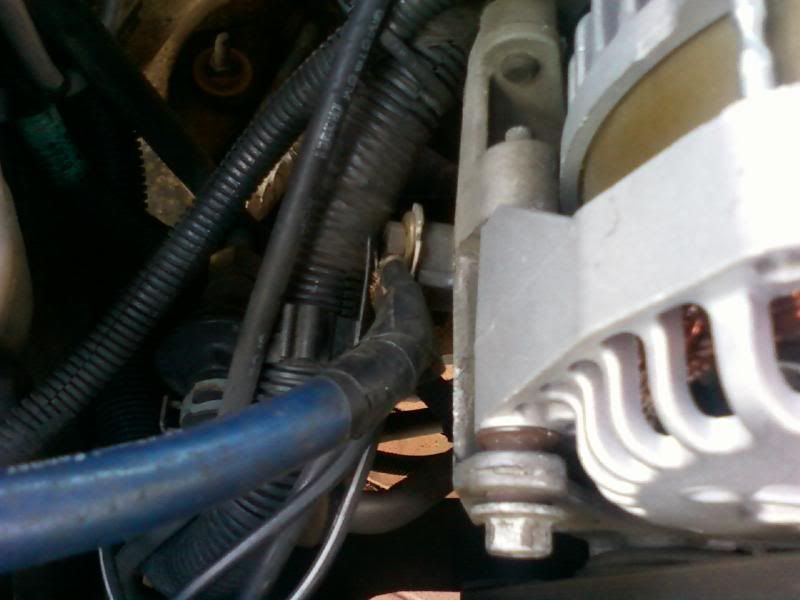

    Ok. I need help from all you spl guys, esp. meca people! I know my set up can do a lot more but not sure what I need to upgrade/do. I'm open to anything. New box/wires/amp/cd player. I took a bunch of pictures of my set up so you guys can see it. Highest i've hit with this set up, 143.8 on the windshield @47 hz. I do not have a meter yet either...
    I've never seen voltage drop, MAYBE .5 for a second.
    My 2 runs of wire between the batteries have been cut up and put together with 1/0 couplers.
    This is for loud daily driver.
    For equipment;
    15 atmos exo
    Audioque 2200d. I'm looking to get the 3500d soon.
    MB quart 4125
    Image dynamics tweeters, dayton 4" mids and phoenix gold 6.5 mids. Even though they don't count in spl, but oh well!
    330 Singer alt
    Xs power 3100, 5100
    2 runs of 1/0. One positive, one negative.
    Big 3 in 1/0 in knu's cca wire. I might upgrade this one first to ofc wire.
    I think that's about it...
    My box build is on here but it's 35x20x18 Slot port; 4.5W 16.5H 18.5L

    where is your port? cause i cant see it at all in any of the pics. also i would ground your rear battery to the front battery and ground the amp straight to the rear battery, if you arent already.

    All he needs is about 6-7" if he has that then he should be ok. I'm thinking the couplers could be hurting his voltage by a couple tenths, also Op did you silicone the inside of the box where the wires ran in the box?
